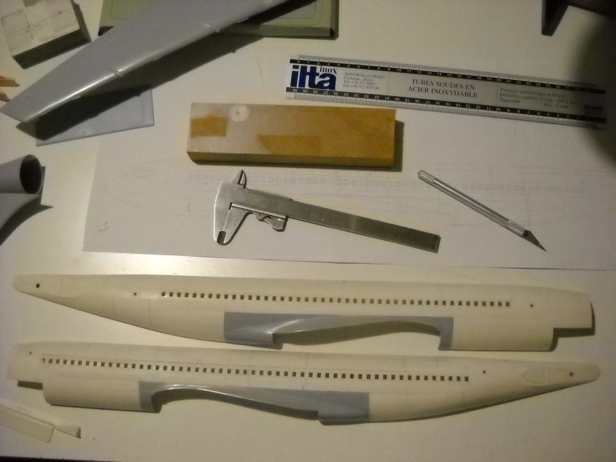

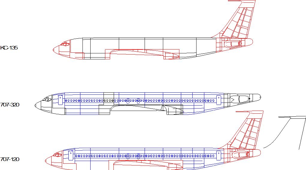

So the plan:
Nose, tail (with vertical stab) horizontal stabs, wings and wing/body fairings from the KC
Shortened rest of the fuselage and wheels from the 300.
I submitted this plan to my friend, she agreed and told me that another modeler made a short body 707 almost that way.

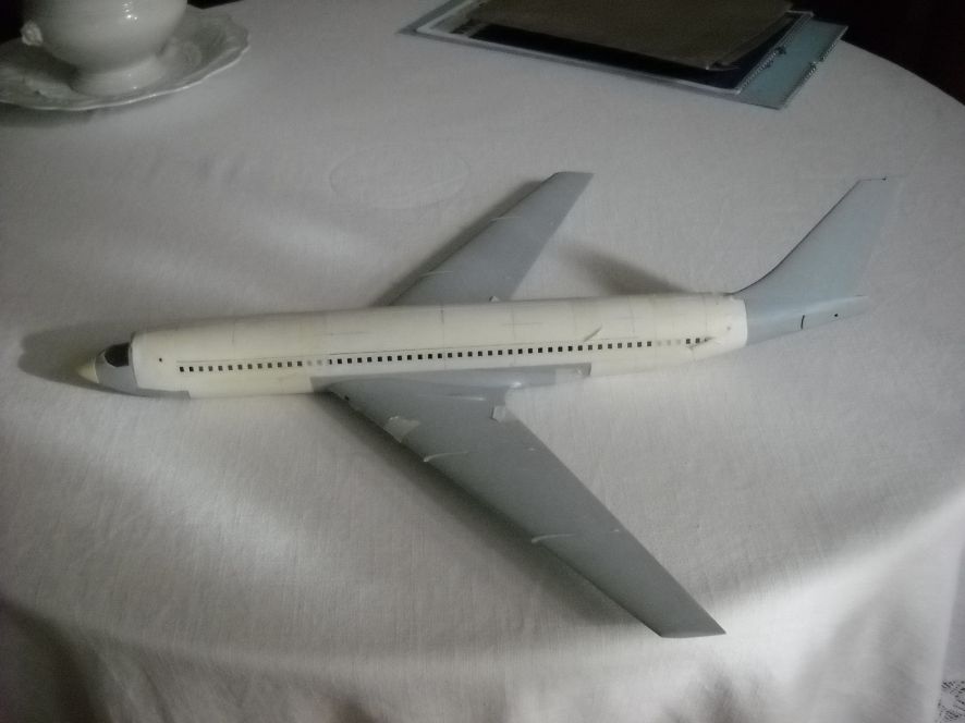

Long story short, some in progress pics.
Some drawings. In red the parts coming from the KC, In blue those from the 300.
The first cuts.
Each fuselage halve joined together with the KC wing to body fairing.
A test rough assembly with the parts taped together.
The vertical fin still has to be shortened.
That's all for the moment.
Thanks for watching.
Eugenio

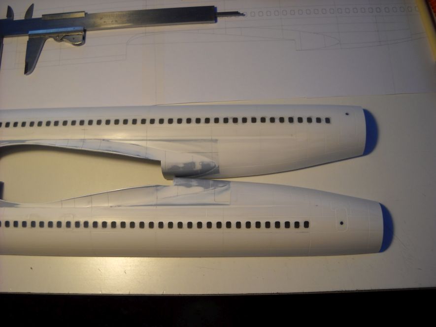

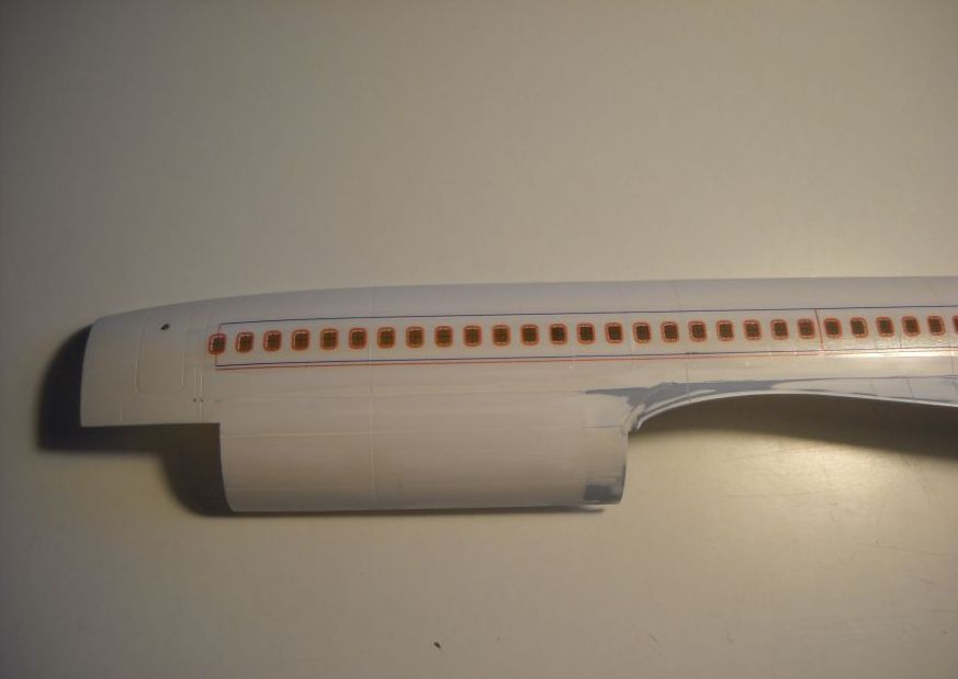

Postby 72linerlover » Sun Aug 02, 2020 6:50 pm
Time for some updates.

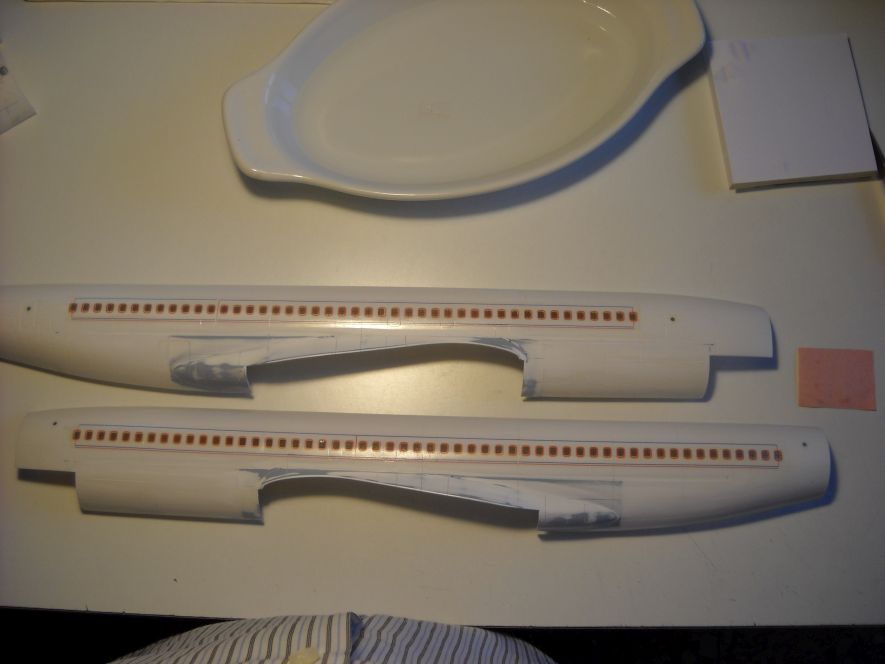

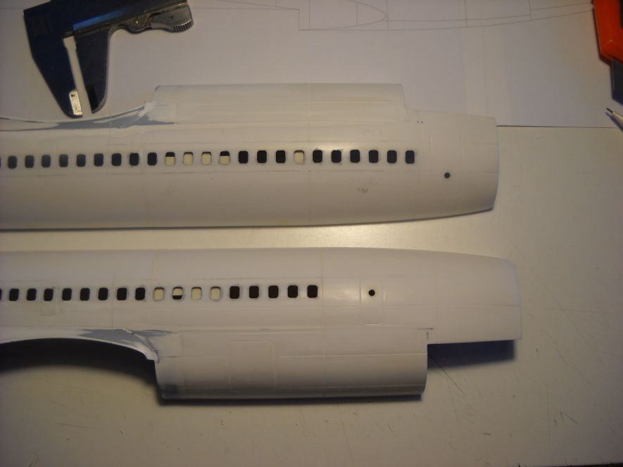

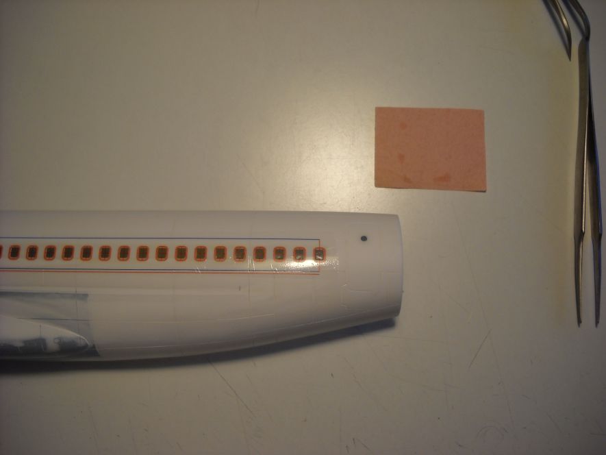

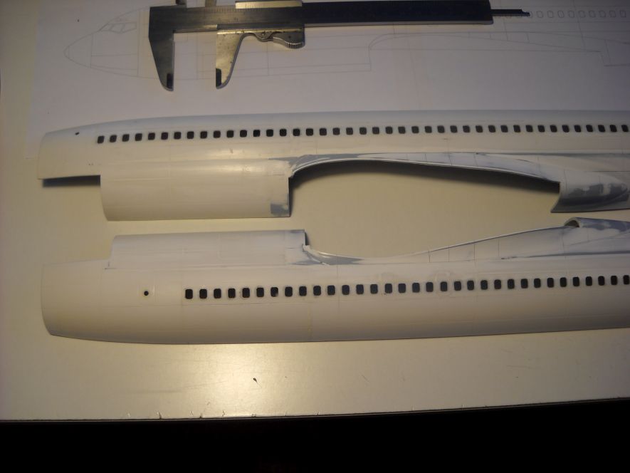

After sanding and rescribing the fuselage halves, I had to face one of the problems of this kit: the windows dimensions.
Fortunately the spacing (pitch) is correct, so I ordered a decal sheet in Germany with metal windows' frames, that I guess are correct.
I redraw the frames, based of a decal scan and printed on a clear sheet. So I got the template to enlarge more than 100 windows.
Boring task, but not difficult. Still on the go.

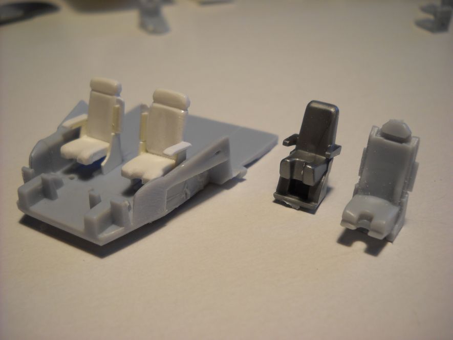

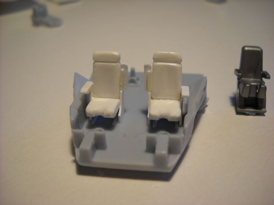

Meanwhile I've got to do something in the cockpit. Non much will be visible, but the pilot seats needed some care. Those contained in the kits are really far away from reality.
So, that's all, folks.
Thanks for following.
Eugenio.

Postby 72linerlover » Sun Aug 09, 2020 7:52 pm
Hi gents.
And thank you, Uros for your interest in this build.

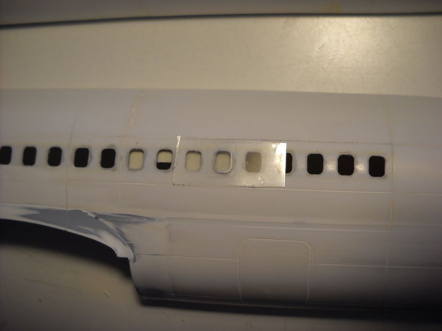

I have completed the windows operation. Now they look a little more similar to the original.
Here is a test with the frames decal of which I'm quite satisfied.

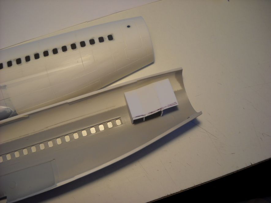

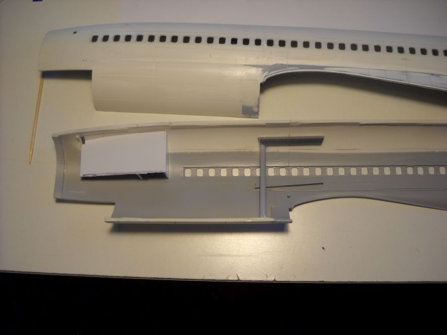

Added some galleys inside
and some shades to hide the internal reinforcements.

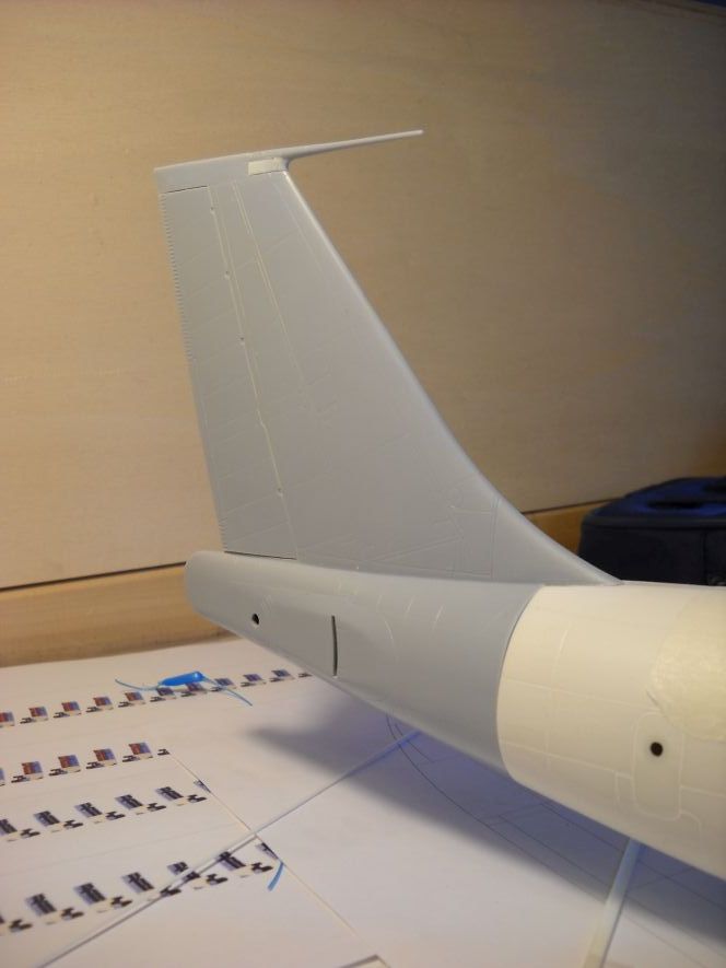

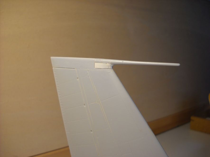

Now to the tail.

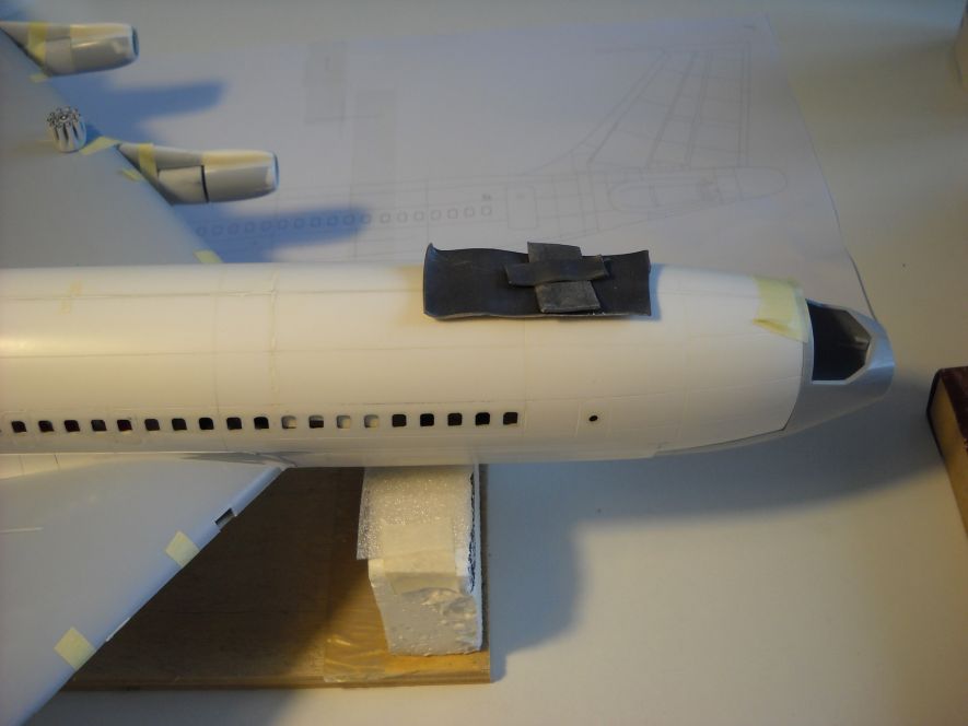

The early built 707s had the original low vertical tailplane, so I cut some 7mm plastic and modified the HF antenna.
Not yet glued, of course.
Test fit of the fuselage halves and the tail cone.
Some recontouring is necessary, but is a matter of fractions of millimetres.

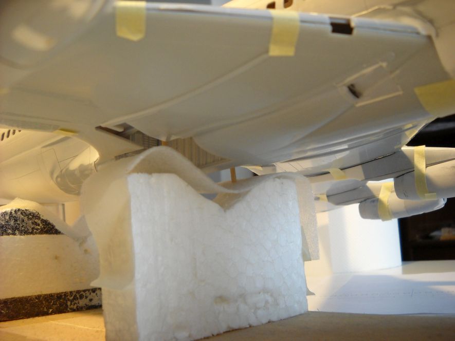

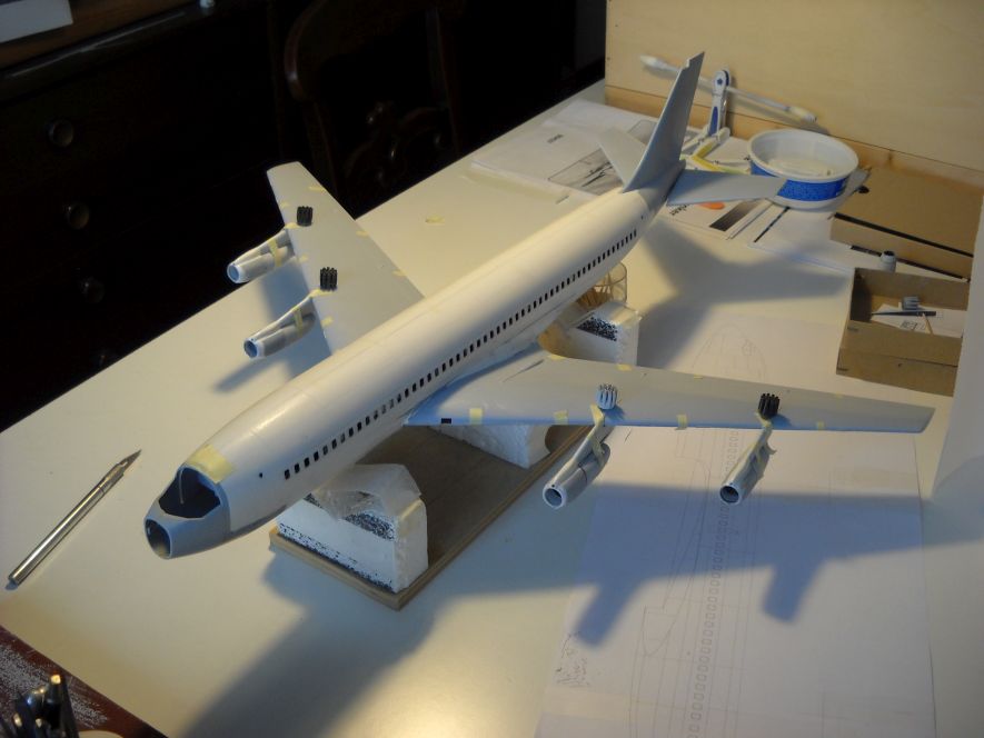

Postby 72linerlover » Sat Oct 03, 2020 6:05 pm
Hi gents, it's time for an update.
Actually I have worked more than posted, so I'll divide the updates in different posts.

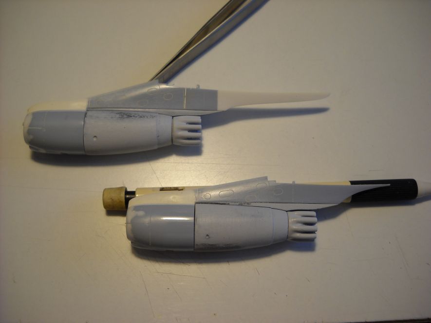

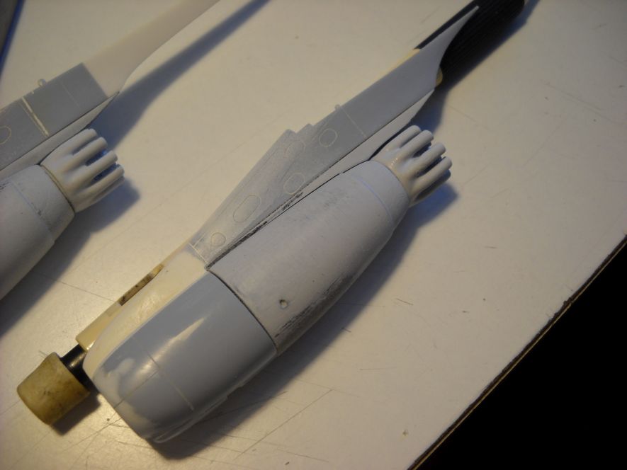

Engines.
As all know, the engines of the first 707s were very different from those of the KC-135: organ pipes noise suppressors, relatively higher nacelles and thrust reversers.
I've considered to use the JT-3C produced by a german cottage industry, but I was not sure of their correct shape, so I 3D modeled and brought the file to a SLA casting shop near me.
Here you see the dry fit test, where the front end is the original kit engine and the other parts are 3D printed. Of course they need to be finished.
The pylons are modified with the front TC inlet. The inboard two are stretched as they have to.
This job gave me the chance to make the balance of the model with all the parts in order to close the fuselage.
The ballast will be inserted from the front, under the cabin floor before glueing the nose.
That'all, for the moment.
Eugenio
