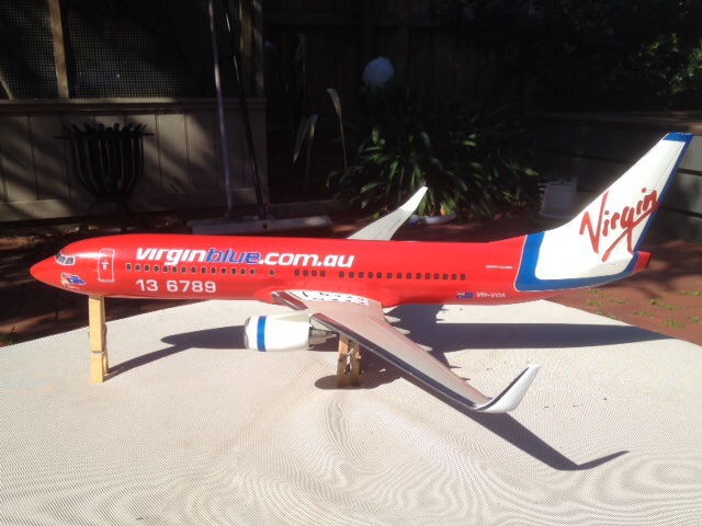

Got some of the decals on today , I must say that it looks alright . Nothing like the real thing of course , as they are faded very badly . It's not perfect , but considering all the dramas I have had with it , it is coming out ok . ;) just need to put some more windows on this side , plus some other details and it's on to the other side .

[quote="Adam the Akrodude"]Oh Great Yoda!
Dual instruction I need! The white you laid down first - airbrush or rattle can? If airbrush, what kind of paint? Same with the red as you sprayed it over the white. Details on techniques I am interested in.
G,day Adam , nothing special just Tamiya undercoat white out of the spray can , then Testors Italian Red out of the air brush . Both were sanded down lightly before and after each coat . Then some good old Future on top of every thing .
Knotty.
