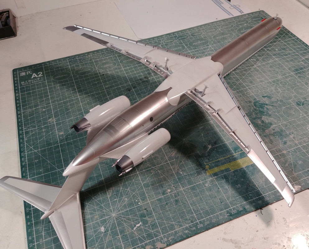

Postby Uros » Fri Jan 24, 2025 7:01 am
Hi! Here's my new project. I'm converting Mach2 Dc-9 into MD82. Scale is 1/72nd and it will be in the colours of Adria Airways. I printed plogs to extend the fuselage. Slats, flaps and engines are from Laci.Ltd. Wings and stabilizers are extended with styrene sheet.
It's looking rough at the moment, but hopefully I'll bring it to shape.

Postby Uros » Tue Jun 03, 2025 6:50 am
Thanks Ray!
Yes, cockpit transparency is polished original part. Cabin window line is to high so I replaced it with clear strips. For me it's easyer to do it that way.
Heres some progress. All parts are glued on and panel lines rescribed. Almost ready for paint.
Posts: 473

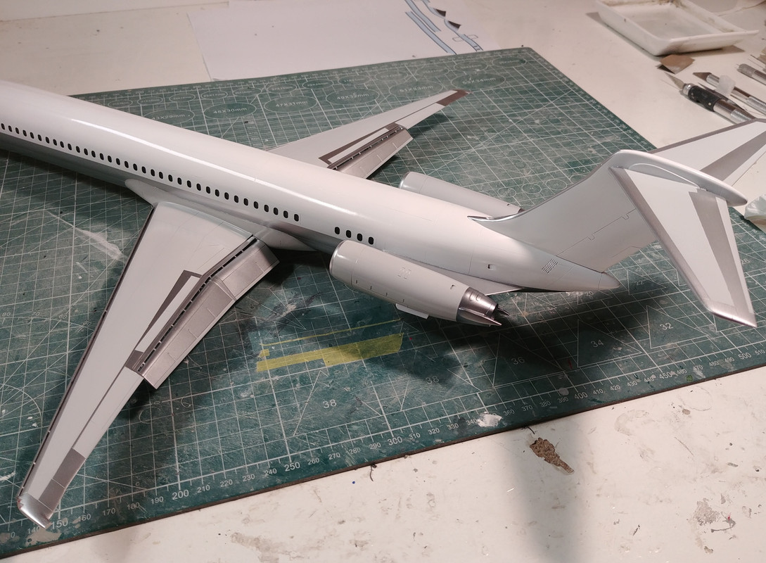

Postby Uros » Thu Jun 19, 2025 6:21 am
Thanks Ray!
It's all pained and ready for decals now.
Posts: 473
Re: Adria Airways MD 82
Postby RayS » Thu Jun 19, 2025 12:23 pm
The paintwork looks excellent!
